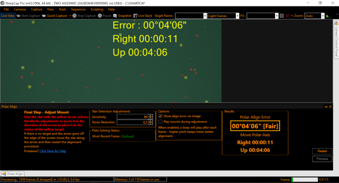

I copy / paste the text i've just posted on sharpcap forum:
Well, finally the wind yesterday gave me a break and as the moon is so bright i took the opportunity to test again.
It works!!!
I can do it without problems but it's like adjusting an elephant position ahahah what a challenge.
To make each fine adjustment i have to lift all the set up (almost 50 kg/110 lbs) in the dark with 1 hand while adjust the equatorial platform legs with the other hand and keeping the bubble level precise which implies loosing fine precision. Crazy. But i have a plan and some ideas and i now will work on different techniques to help specially older people to do it without any effort. Patience and time will be the way to go. Also a dedicated fast technique for stressful / urban / young fellows that can't wait eheheh.
First i will play with this for a while because i suspect that for heavy set ups like mine, harder to fine tune, may be better to have a "fair" result on average rather to try reach a "good". I don't know yet. As said, it's like fine tuning an elephant. So i will test, test, test and test until i get a firm conclusion about the best methods and results.
In my case since i upgraded my equatorial platform from 3 to 5 legs a few days ago, i then had to realign it so i was already close with the drift method but was an opportunity to try sharpcap polar align feature. I was on "fair" already and after 1 or 2 "elephant tweaks" i kept on "fair" but a much better tuned "fair". I left it like that last night, as picture below.
The most important is that now we can do it. Finally a Dobsonian telescope can be polar aligned with sharpcap!!
Now i will keep working on this and then i will record a video and post here and everywhere, to allow dobsonian users to benefit from this feature in a smoothest way possible.

I observe almost all nights and i keep making readings with this PA feature. I make at least 2 readings each session. Lots of readings so far.
At the beginning i was having every night results around FAIR/GOOD/EXCELLENT but since i've changed my telescope weight (lighter now) i'm having trouble to have consistent results with the software although it keeps aligned as i can confirm by the images and drift patterns. I will need more time to figure what happened. Unfortunately i can't shout victory yet with this feature and my set up. The consistency fails only on declination readings and make no sense because it can give an error to the UP side and after one hour an opposite error to DOWN side without any latitude changes in the platform, of course. My bet is that when i reset the platform now, it changes altitude position because of the tube moving. I may try with the springs more tight to avoid the heavy tube to shake.

Unfortunately i suspended this experience a week ago. I have my setup polar aligned by the drift method and using the sharpcap PA feature keeps returning nonsense results. I tried everything i could think but it just can't have consistent readings even knowing i have it aligned. So i give up.
I'm not sure but i think the problem is that my eq platform reset button do the reset fast and with strength and the telescope always bump after reset. Although this doesn't affect the alignment at all and it's comfortable not to wait for the reset too long, it will affect a precision measure from point A to point B as sharpcap do so this can't be done with my setup. It's a beast.
Thus in my situation the drift method using sharpcap live stacking still the best method for me to fine tune, simple and easy, although require time to watch and correct the drift and that's why i put an effort in sharpcap PA feature to work.
At least we've tried, thank you Robin to support this experiment, and the door is open because i believe that this still can be done with a different dobsonian set up. May be someone in the future can make it work and worth...
