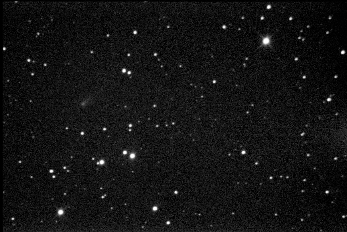

I captured Comet Borisov on my second outing. It isn't a pretty object, but it was an interesting challenge.
The skies were average. This means, that the stars were dancing at the low altitude of the comet. I was also shooting over the top of a large building that has floodlights. And I was shooting over the top of a light dome. This was least desirable of all possible positions for my location (of course).
The comet was mag 16.3 at the time.
The comet appears to be elongated in the integrations, due to it's movement. The comet appeared more star like in single exposures. I was trying to lock on to, and therefore freeze, the comet with the autoguider when I ran out of time and the sun came up.
Tips:
If you try to capture this comet in Sharpcap, be sure to turn off Sigma Clipping or it will eat some of the comet tail.
I used this online calculator to convert the comet's J2000 coordinates that are reported online, to JNOW coordinates that I could use with CdC. The conversion worked like a charm and the comet was near the center of the field on the first try.
I tried various exposure lengths. There wasn't much difference. 30 second exposures had a slight advantage.
ASI183MM Pro, 4x4 bin (1.1 asec/px), gain 130, cooler -30F. SkyWatcher 16" 1800mm f4.4 Newt on GEM, autoguided. Cartes du Ciel, Sharpcap, PHD2.
9x30 sec, saved as viewed, cropped
Borisov 9x30sec.png (360.93 Kio) Consulté 1359 fois
243x5sec This image shows how far the comet moves in 20 minutes
Borisov 243x5sec.png (437.21 Kio) Consulté 1359 fois

I like that. Maybe one day, I would do the same thing.... :D

Woaw, very nice challenge and for a comet with this magnitude you have a beautifull result :D
Could you tell us the field size of you fisrt crop ?
Edit: ok found it :D

You did great. :clap:
You were looking for new challenges, I think you found one.
Thanks for the tip about turning off Sigma Clipping when stacking a comet. 8-)

Thank you Ubuntu, Here is the full image. I had cropped it for CN to meet their image size limits. I forgot that we don't have those limits here. ;)
