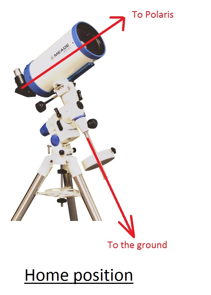

En gros c’est ça : tube pointé vers la polaire et contrepoids vers le sol
https://stargazerslounge.com/uploads/mo ... 728923.jpg

position zero
Si le tube est pointé vers la Polaire on doit lire 90° sur l'axe de déclinaison
Pour 0° le tube est horizontal
Tu as un lien pour la notice?

position zero
Ma remarque s'appliquait aux équatoriales ancien modèle
La position zéro doit être la position de parking de la monture; tu verras ce qui se passe en appuyant sur le bouton
Cela correspond aux indications de @clouzot contrepoids vers le sol, axe pointant vers le pole céleste
A mon avis:Zero Position: The reference position for GOTO. The mount can move to Zero Position using “Goto Zero Position” or “Search Zero Position” command;
User Position: The mount is pointed to a user defined position, which could be a particular celestial object or simply a position determined by pressing an arrow key;
Il est bien spécifié qu'il faut d'abord placer la monture à cette position zéro (qu'elle doit connaître ? ) avant de commencer la procédure d'alignement.4.1. Setting the Mount and Performing Polar Alignment
Assemble your CEM70 mount. Make sure the mount is leveled. Mount an OTA and accessories, and carefully balance the mount on both R.A. and DEC axes. Turn the mount power switch on. When the GPS receiver is connected to satellites, the hand controller LCD will display GPS OK and the mount will have the correct time and site information (this can also be entered manually as previously described). Polar align the mount. Always check if the mount is at the Zero Position when the mount is powered on, i.e. with the counterweight shaft pointing to ground, OTA at the highest position with its axis parallel to the polar axis and the telescope pointing to the Celestial Pole. Press MENU => “Zero Position” => “Goto Zero Position” to check it. If the mount is not at the Zero Position, press MENU => “Zero Position” => “Set Zero Position.” Release the Gear Switch to manually return the mount to Zero Position, or use the hand controller to slew the mount to Zero Position. Press ENTER to confirm the zero position.

position zero
En principe la monture connaît la position zéro; mais elle peut la perdre: mise à jour du firmware, remplacement de batterie,...5.10.2. Set Zero Position
This set the Zero Position for the firmware. The Zero Position reference will be an undefined value after firmware upgrade, or it may lost during power outage or HC battery replacement. You can use this function to set the zero position reference. Press the ENTER after moving the mount to Zero Position either manually or with the hand controller.
En ce cas il faut la réinitialiser avec cette fonction "Set Zero Position" après avoir placé la monture dans la position correcte

position zero
A priori cette position "zéro" est bien celle que je te donnais : tube pointé vers le nord et contrepoids en bas, vers le sol. C'est la position de référence, qui permet à la monture de réutiliser un alignement déjà effectué par le passé.
J'ai lu rapidement le manuel est il ressort que :
- la position zéro est réglée d'usine
- la monture peut l'oublier si jamais elle est réinitialisée (comme le traduit @pejive juste au-dessus, par exemple dans le cas où tu mets à jour son logiciel interne)
- mais la monture peut "retrouver" cette position par défaut (il doit y avoir des repères spécifiques sur chaque axe, à défaut d'encodeur puisqu'il me semble que tu n'as pas la version dite "EC") en bougeant lentement ses axes jusqu'à retrouver les fameux repères d'usine.
Attention, ce n'est pas forcément la position Park. Le Park, c'est vraiment pour "ranger" la monture, et la position zéro n'est pas forcément la bonne position de parking car le tube est tout en haut et pourrait éventuellement toucher un toit (par exemple un toit télécommandé comme celui de @bemo47 ).

position zero
oui la position zéro ou "HOME" c'est bien celle tube pointant la polaire, contre poids en bas comme sur le schéma de @clouzot
mais tu veux utiliser ta monture en mode connecté avec EQMOD ou GSS ?
car là il y a une petite subtilité qui m'a fait chercher longtemps, je faisais tous les pointages comme dit, mais quand je lançait le 1er GOTO ma monture partait pointer allègrement le sol !!! Ca partait jamais dans la bonne direction.
Si c'est un souci comme ça que tu as, même avec la raquette d'ailleurs, dis le et je te donnerai une toute petite procédure qui synchronise tout.
