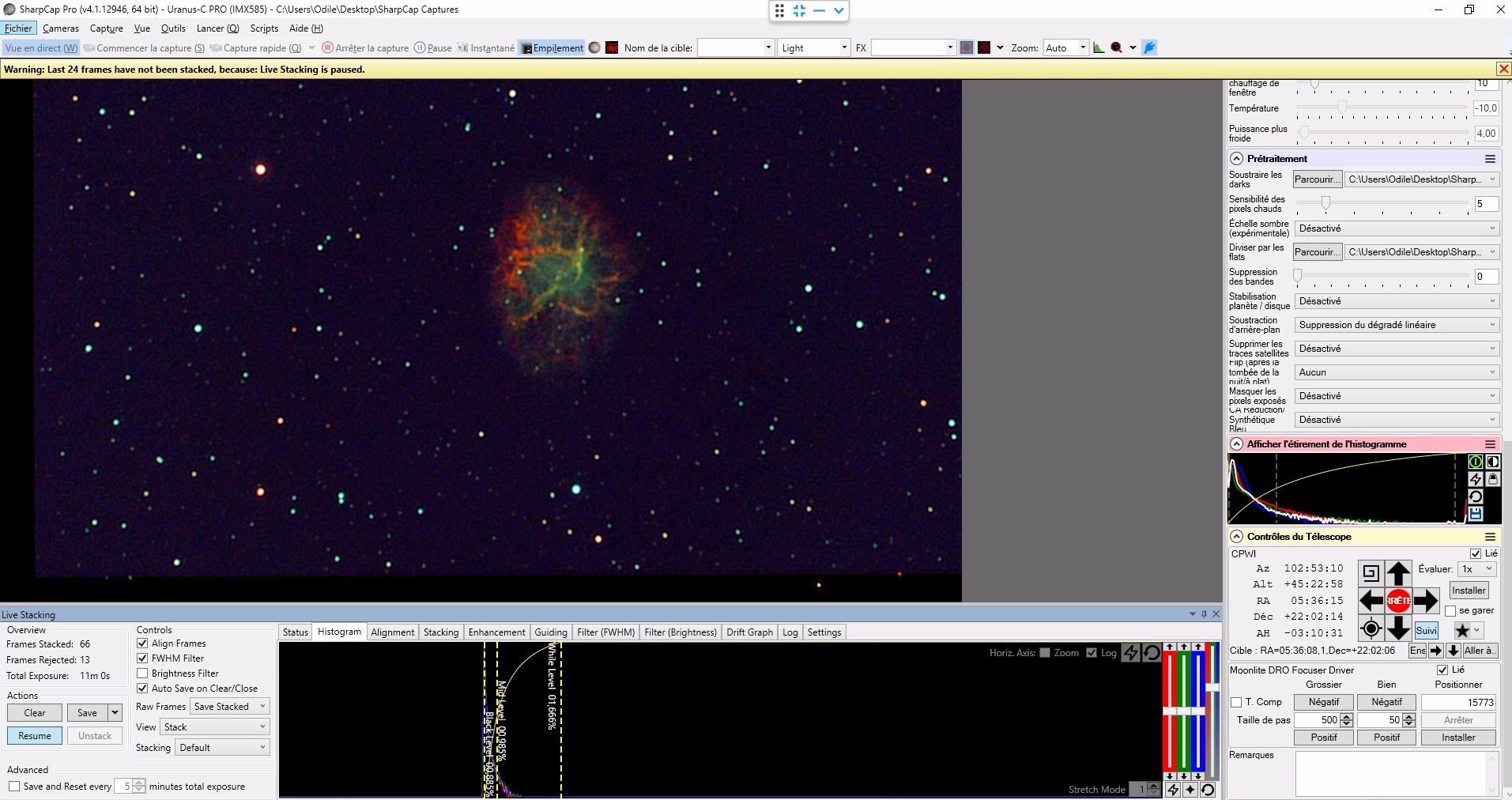

C'est reparti pour ce soir et en bon boulet, j'ai encore des question.
Qu'est censé faire l'option que j'ai entouré sur la copie d'écran ?
Voici donc M1, stack de 11 minutes en poses de 10s, gain 210, offset 6, dark et flat, L-Enhance et l'option dont je parle ci dessus et enhancement weiner deconvolution
Et la même en 10 minutes gain 498, offset 120, La nébuleuse claque plus (on découvre la teinte verte un peu plus) mais le bruit aussi il me semble

débuts en VA de darki
Message par pejive » 17 janv. 2025, 19:13
https://docs.sharpcap.co.uk/4.1/#Image% ... 20Controls
There are various options for Background Subtraction, which change the details of how the background to be removed is calculated:
· Simple Offset – will apply the same, auto-detected correction to all pixels in the image. This may affect the colours of bright stars as (for example) an orange/red sky glow will lead to the largest reduction being applied to the red channel, possibly making bright stars take on a blue/green hue.
· Blended Offset - will cause SharpCap to avoid making such large adjustments to the brightness of pixels that are close to full brightness – this will reduce or eliminate any shift in star colours caused by the background subtraction option. This option should be preferred in most cases over ‘Simple Offset’.
· :arrow: Linear Gradient Removal – rather than use a single, constant, background value across the entire frame, in Linear Gradient Removal mode, SharpCap will look detect and remove gradients in background brightness across the frame. The brightness adjustments are applied in a manner similar to Blended Offset to avoid colour changes to bright stars.
This option can detect horizontal, vertical and diagonal gradients. It should be used with caution in cases where nebulosity covers all or most of the frame, as it may mistakenly detect brightness patterns in the nebulosity as a background gradient.
· Non-Linear Gradient Removal (Experimental) – this option attempts to fit a second order polynomial curve to the background brightness of the image to allow removal of gradients that do not vary linearly across the image.
In cases where the background is correctly detected, this approach will remove it more effectively than the Linear Gradient Removal. However, this approach has more freedom to produce different shapes of background (6 free parameters per colour channel rather than 3), so there is increased scope for this option incorrectly picking up other patterns in the brightness of the image such as variations in nebulosity. As such, it should be used with caution.
· Low Frequency Wave (Experimental) – this option attempts to fit a combination of linear gradient and sine and cosine waves (with a wavelength equal to the image dimensions) to the background brightness pattern of the image. The same cautions as for Non-Linear Gradient Removal (Experimental) apply – this option has 11 free parameters so may give a better fit to background gradients but may also incorrectly attempt to fit to other brightness patterns in the image.
DO NOT capture calibration frames (flat, dark, bias, dark flat, etc) when this option is enabled. This option should only be used when capturing light frames.
:lol:
Message par darki » 17 janv. 2025, 19:33
Si je comprend bien ca fait ce qu'on fait dans siril "suppression du gradient" ?
