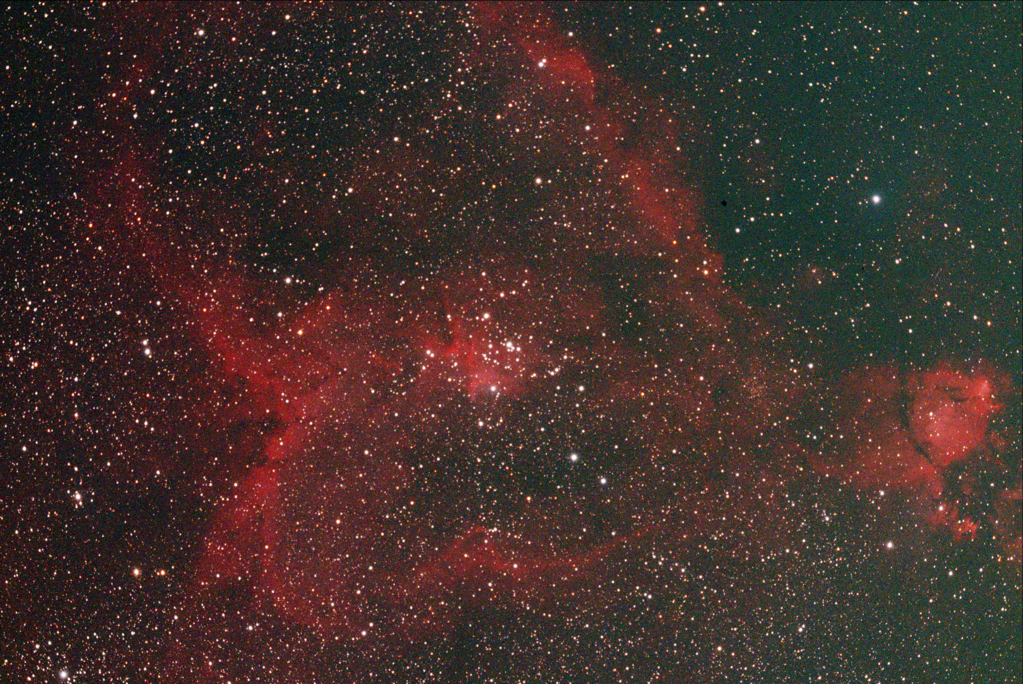

IC 1848 Stack_68frames_2036s

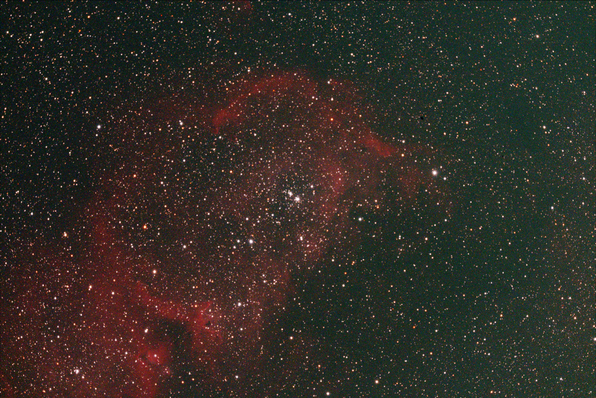

IC 1805 Stack_44frames_1320s

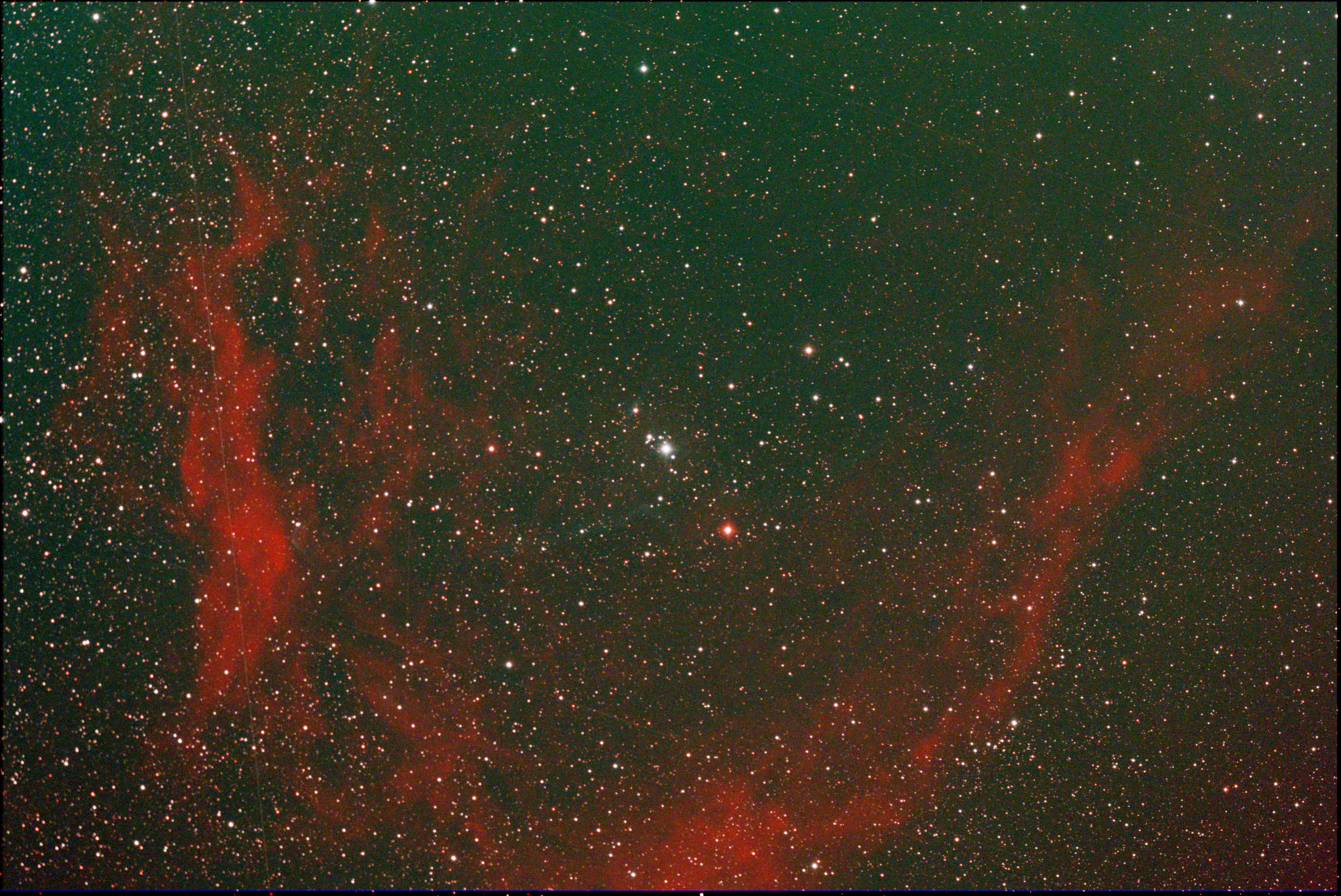

NGC 2403 en 13x10s
IC 1848 en 5x20s
IC 1805 6x20s
NGC 149915x20s
M81 M82 et NGC 3077 en 15x10s
