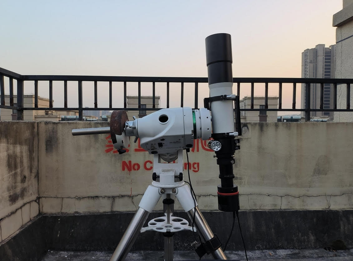

Something about flat testing:
1. using sky to take flat frame.
2. Focus point same as light frame.
3. Stack flat use "median" method, not "average".
Test1: livestack without and with flat frame.
without flat:
With flat
In our research, it is can be calibrated for sure with right steps.
